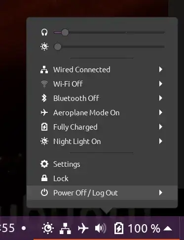

You may be able to solve this more simply by going to menu > settings

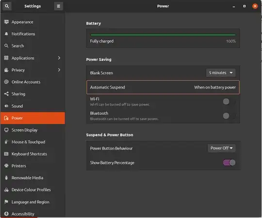

Then select power
Then automatic suspend and set the values you want.
