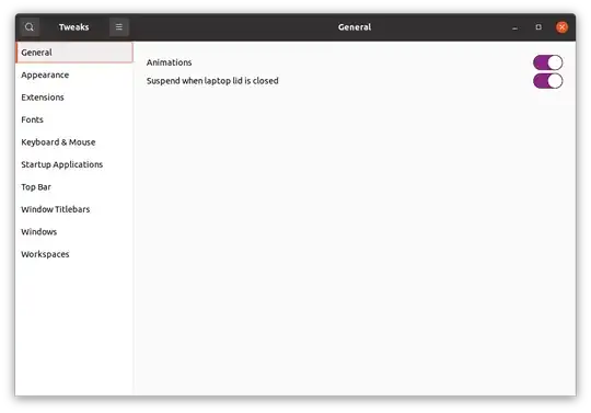

Tested on Ubuntu 21.04, the GUI option is available on gnome-tweak-tools:
sudo apt install gnome-tweak-tools
gnome-tweak-tools
under:
  • General
  • Suspend when laptop lid is closed
Asking at https://gitlab.gnome.org/GNOME/gnome-control-center/-/issues/1384 why not just add it to the main settings.
