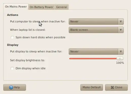

These settings are in System -> Preferences -> Power Management.
power management
