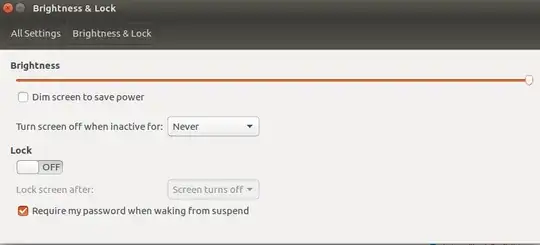

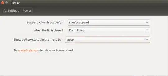

I'm trying to use my laptop as my alarm so I did the below settings to prevent suspension. However when I tried closing and opening my laptop lid after a few seconds, it didn't suspend.
Settings 1
Settings 2
Feeling satisfied, I closed my laptop lid and went to bed, but the alarm didn't ring the next morning and the laptop got suspended for some reason.
What am I doing wrong here? Are there any settings I'm missing?

Try to make two more changes, one of them or both of them:
1) Setting IgnoreLid=true in /etc/UPower/UPower.conf
Found here: How can I tell Ubuntu to do nothing when I close my laptop lid?
2) I had a different problem in 16.04 LTS with a laptop lid as well. I could not boot with the lid closed and was suspended.
I solved it by going to /etc/systemd/logind.conf and doing two steps:
a) Removed "#" from HandleLidSwitch, in order to activate it and
b) put "=ignore at the end
HandleLidSwitch=ignore
You will also found the second step at the same link as the first one. Hope they will help.
