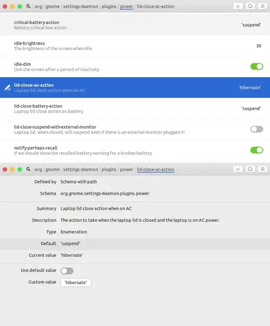

Using a gui
If you prefer a gui based solution, you have to install
sudo apt install dconf-editor
Invoke with
dconf-editor&
or by searching the program dash.
Go to the /org/gnome/settings-daemon/plugins/power/lid-close-ac-action schema as show in the first line of the images shown above, and make your settings:
