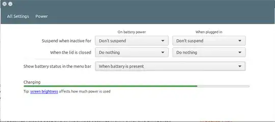

  1. Under System Settings I closed suspend or hibernate settings from Power and Brightness

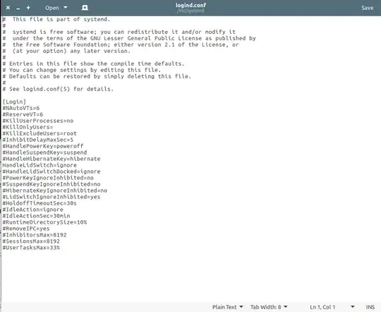

  2. As this topic suggest I edited my logind.conf and madeHandleLidSwitch=ignore(and it is not commented)

Here are my settings: enter image description here enter image description here enter image description here

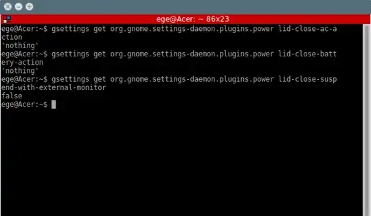

The Output of Gsettings: enter image description here
