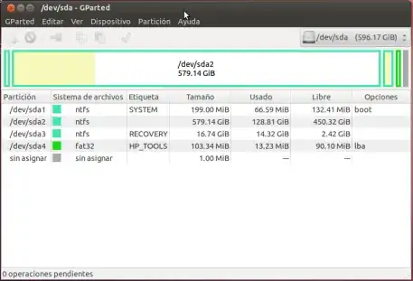

I would like to install Ubuntu alongside Windows 7 on a HP G62 Notebook. Although I have installed Ubuntu in a dual-boot many times before, I found out that this model has already four partitions.
GParted Screenshot
Partitions:
  1. SYSTEM (NTFS, 199MB, used 66.59MB)
  2. Partition without any tag: NTFS (579GM, used 129GB)
  3. RECOVERY (NTFS 16.74 GB, used 2.42GB)
  4. HP_TOOLS (FAT32, 103.34 MB, used 13.23MB)
Since I am not an expert with partitions I would like to get advice on how to do this.
My first idea is this one:
  • Free some space from /dev/sda2 (I don't know if could also free some other space)
  • delete the HP_Tools partition (I have already created a backup)
  • create an extended partition with the free space in #1 containing three parititions: swap (1gb); / (EXT4, 30GB); /home (EXT4, 120GB)
Another option is to use wubi instead.
What do you think? Is there any other way to achieve this?

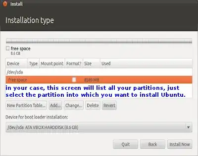

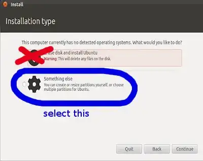

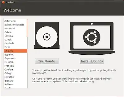

Here's what you need to do.
  • Boot from the bootable Ubuntu USB or CD.
Ubuntu Installation page 1
  • Select Install Ubuntu.
Ubuntu Installation page 2
  • Click Continue.
  • Select the ”SOMETHING ELSE” option.
  • Click Continue.

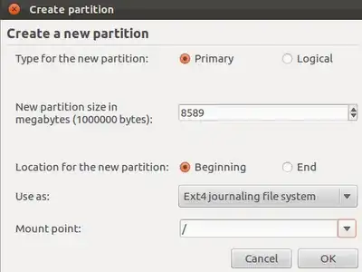

  • The window below will appear. Select the partition (empty or without important data) wherein you want to install Ubuntu. In this example it is shown as free space, in your case, just select the partition you don't need or would like to put Ubuntu into. It doesn't matter if it is an NTFS partition because you can format it to another partition on the next screen. In the Device for boot loader installation, select your hard drive, not a partition.
  • After selecting the partition, click on Change. In the “Use as” option select “Ext4 journaling file system” and select mount point as "/". Press OK.

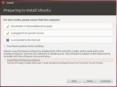

Ubuntu Installation page 5
  • Click on "Install Now".
  • Reboot and you should see the grub menu prompting you to choose which OS you want to boot into. By default, the last OS installed (Ubuntu) will be the default OS. You can press Enter to boot into Ubuntu or use the up or down arrow to select another OS (windows) to boot.

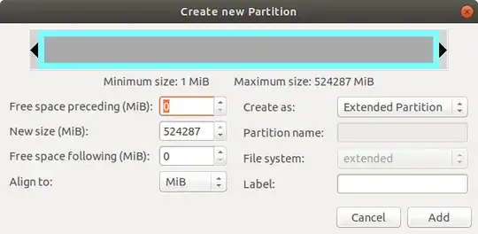

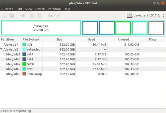

Creating an extended partition
Creating an extended partition in GParted is done the same way as creating a primary partition.
  1. Select an unallocated space on the disk device.
  2. Choose: PartitionNew. GParted will open a new Create new Partition window.
  3. Specify the size and the location for the partition.
  4. Specify the alignment for the partition.
  5. Specify the type of partition.
  6. Specify the name of the partition when the field is enabled.
  7. Specify the type of file system for the partition.
  8. Specify the label of the file system for the partition.
  9. Click the Add button to add the create partition operation to the operation queue. GParted will display the pending create partition operation at the bottom of the GParted window.3

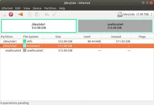

Notice the dropdown menu selection in the "Create As" box where Extended Partition is selected. When Extended Partition is selected, all the file types in the menu below will be greyed out. There is no file type associated with an extended partition. An extended partition is basically a container for any number of logical partitions, which can be of any file system format.
The created extended partition is shown in the above screenshot. You would normally cover the entire remaining free space with this partition unless you intend to install another operating system which requires free space to be installed into. The extended partition is represented by a box in the graphics portion surrounding the remaining free space. The extended partition can be resized to create room for expansion of the existing primary partition or the creation of an additional primary partition(s).
You will notice a third partition type option in the "Create As" dropdown menu. This option is to create a logical partition inside of an extended partition.
When you click on a free space, which type of partition that may be created depends on the location of the free space you are selecting. If it is outside of an extended partition, you will only be able to create a primary or an extended partition. If the free space resides within an extended partition, you will only be allowed to create a logical partition. Creating a logical partition is otherwise exactly the same as creating a primary partition.
Below all the partitions except for one primary NTFS partition (which would normally contain the Windows operating system) have been deleted and replaced with an extended partition covering the rest of the free space. There are a number of logical partitions inside of it to demonstrate how an extended partition works.
Notice that there are the original Linux partitions and 5 more partitions, called logical partitions, of various filesystems within the extended partition that demonstrate how an extended partition works. Note also the order of the list of partitions in the screenshot. Any partition that precedes the extended partition is a primary partition. Those that follow it in the list are logical partitions. You can create any number of logical partitions of any file type and any size within this extended partition.4
Sources: 1 2 3 4
