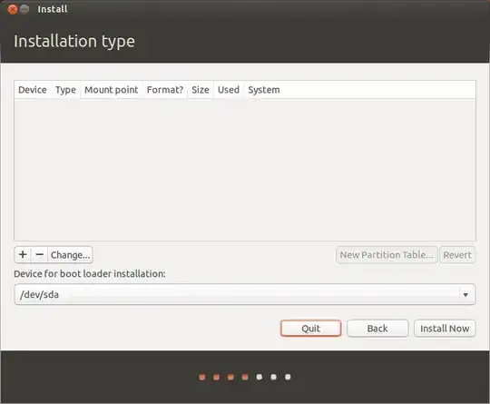

I have a HP EliteBook 8570w with Windows7 pre-installed. when I try to install ubuntu from either a disk or a USB-stick, it skips the third step and I don't get to see any partitions at all:
Installation window
The output of sudo fdisk -lu:

In Windows I've tried this but it also didn't solve my problem.
Setting my SATA mode from RAID to AHCI
This didn't work out either. I had to reset it to RAID to get Windows7 working again
Installing 12.04 instead of 13.04
But the problem keeps persisting
Disabling my SLC mSATA cache module
Windows wouldn't start again and the problem persisted
If anyone could provide me with an answer I would be delighted. Thank you in advance.

You also have the 4 primary partition issue.
My laptop already has 4 primary partitions: how can I install Ubuntu?
Be sure to create recovery DVD(s) first as well as a Windows repair CD.
HP Tools Partition discussion
If you shrink Windows using Windows disk tools and backup HP tools. You can then use gparted to create one large extended partition and have many logical partitions. You can restore HP tools in one if you want. You can make a shared NTFS data partition if you want and you can install Ubuntu in / (root), swap and /home again if you want that as a separate partition.
Update:
If system was an Ultrabook it has Intel SRT which somehow uses RAID. You need to turn off the SRT and then remove the meta-data on both drives. If still booting Windows you can turn SRT back on and it should work.
sudo dmraid -E -r /dev/sda
sudo dmraid -E -r /dev/sdb
Some other issues can be dynamic or LDM partitions if you used Windows to create extra partitions, or left over gpt backup partition table where drive was gpt and you use Windows install in MBR mode.
oldfred
  • 12,583
http://ubuntuforums.org/showthread.php?t=1970636
If you read this thread, the moderators answer to the OP suggests that if you run gparted from a live cd / usb and partition your drives yourself beforehand, it will solve this glitch, and also speed up the install process, since it can now use the swap partition to speed up the process.
Google how to make a gparted live usb/cd, whichever you prefer, and format your partitions with however much space you want for the root system, a separate /home if you like, and a swap formatted partition equal to the amount of ram you have, measured in GiB (according to the moderator in the linked forum thread).
