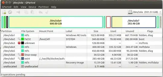

Actually if you did its better. As others has said its ok. If you didn't unless you know that you won't run out of ram. But in case if you needed. You can reserve a pen drive to the swap. Its simple through Gparted
