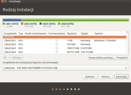

I know there were many questions in this area, but i'm still unable to install ubuntu without formating whole disk.
I've got Windows 8 and 4 partitions 100 GB - windows 30 GB 117 GB 418 GB and 30GB unallocated space I made in Windows Disk Management Tool (I thought Ubuntu will see it)
Ubuntu (Live) can perfectly see all partitions and I have access to it:
sudo lsblk -o NAME,FSTYPE,SIZE,MOUNTPOINT,LABEL
NAME   FSTYPE     SIZE MOUNTPOINT                       LABEL
sda             698,7G
├─sda1 ntfs       100M /media/ubuntu/Zastrzeżone przez  Zastrzeżone przez system
├─sda2 ntfs     100,9G /media/ubuntu/8EF8F38DF8F37237
├─sda3 ntfs        30G /media/ubuntu/10A28513A284FF0A
├─sda4 ntfs     117,7G /media/ubuntu/Muzyka             Muzyka
└─sda5 ntfs     418,4G /media/ubuntu/Nowy               Nowy
sdb              14,7G
└─sdb1 vfat      14,7G /cdrom                           EJZEPEN
sr0              1024M
loop0  squashfs 842,7M /rofs
But installer sees disk like that: (see screenshot)
I want to install Ubuntu on 30GB unallocated space or make a new partition out of "Nowy" partition without without formatting it.
