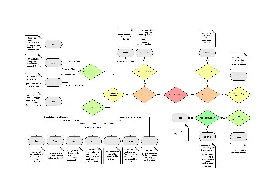

Late Answer - I've created a roadmap for beginners to follow. If they are looking for a file but don't know where to look, they can use the map to roughly navigate around. You can download a hi-res PNG here. You can find the related post here. I will keep updating both the file and the post when time permits, incorporating helpful comments.
