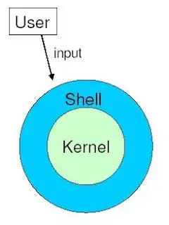

Shell is basically Bridge between kernel and the user, a Command Interpreter where user can type command and the command is conveyed to the kernel and it will be executed.And it is Different from Kernel , refer basic image below

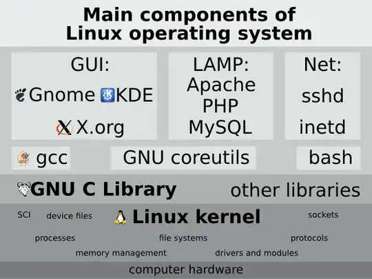

And for more descriptive image
File Manager mostly forms the Front-End of common Core Utilities.
So how does that innate thing happens , its because ,
Linux is Monolithic kernel where all services (file system, VFS, device drivers, etc) as well as core functionality (scheduling, memory allocation, etc) are a tight knit group sharing the same space. It provides the shortest path to a working, stable kernel .Whereas Memory, Process and Device managing are the functions of any Kernel.
