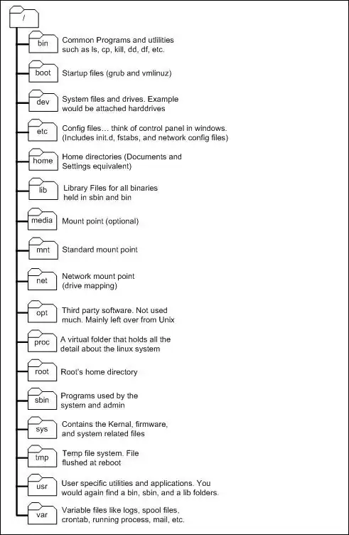

/dev is system directory that contains all Hardware device related files. Check out this manual for Ubuntu Filesystem Tree Overview and this also.
