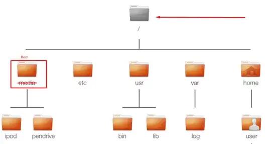

Tommy
Picture of Linux filesystem
I just created a picture for you to make it clear. The Linux system is like a tree. The bottom of the tree is the "/". The /root is a folder on the "/" tree.
