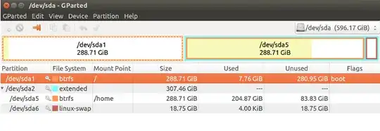

Please take a look at my current partition set up: enter image description here
Partition    | File system   | Mount Point | Flags
/dev/sda1    | btrfs         | /           | boot
/dev/sda2    | extended      |             |
  /dev/sda5  | btrfs         | /home       |
  /dev/sda6  | linux-swap    |             |
Questions:
  1. How do I know if all my personal files such as: videos, musics, work docs, php scripts, web templates, etc .... are been saved in sda5/home?
  2. How can I make sure Ubuntu is installed on sda1?

Question 1
It's pretty likely that all the files are in /home/USERNAME since it's the default save location for all those. Although an app (or you) may have chosen to save some files elsewhere.
Question 2
Sure, it's installed at /dev/sda1 - you can figure that out by looking at the partition setup image you gave, since / (the root of the filesystem, where Ubuntu installs to) is mounted at /dev/sda1.
