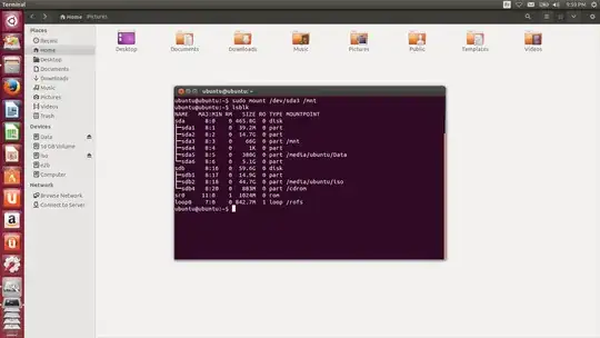

Here is a screenshot I made with a liveUSB, showing all three cases: Nautilus displaying unmounted/mounted devices that go to /media but not to /mnt
  • auto-detected devices not mounted ("16 GB Volume" /dev/sdb1)
  • devices mounted on a /media subdirectory and showing up in Nautilus ("iso" /dev/sdb2)
  • my Windows partition /dev/sda3 mounted on /mnt but not showing up in Nautilus left pane (it would be the same if it wasn't mounted since I have an entry for it in my fstab).
On the contrary, I want my shared data partition to show up in nautilus, so I assigned a /media mount point to it and set the auto mount option, so I can just click on Data and access it from the GUI.
To me this is THE big difference between those two directories, that I learned about when trying to do just what I explained ;-)
