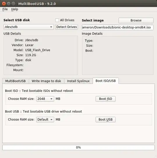

MultiBootUSB - QEMU
If you want to boot ISO files with the least hassle and don't need persistence, MultiBootUSB includes a QEMU option:
  • Start MultiBootUSB and select the Boot ISO/USB tab.
  • Drag and drop the ISO on the Select image space.
  • Select RAM size and hit the Boot ISO button.
You don't need to edit grub.cfg or even log out.
MultiBootUSB-QEMU

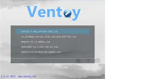

This may be the multiboot solution that you need.
https://www.ventoy.net/en/index.html
This bootable USB maker creates two partitions in a USB drive. One is 32MB FAT 32 EFI partition. Another one is exfat partition that is equal in size to the rest of the USB drive. You can copy any number of ISOs including Windows to either the root folder or any subfolder. You can also use this partition for normal storage.
Select this USB in the boot menu and it will show all the supported ISOs as a list to choose from. In my experience it worked for Ubuntu, Kubuntu, Mint, Clonezilla and Windows.
Ventoy
