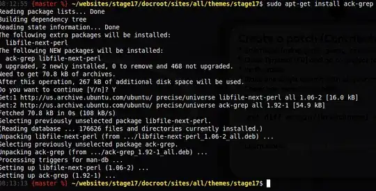

After installing apps via apt-get install -app name-. Where does the files get copied to? Are the copied to just one location or multiple locations? And if so how do I find this out?
Here's an example:

From the link it states that these are the files:
/usr/bin/ack-grep
/usr/share/doc/ack-grep/NEWS.Debian.gz
/usr/share/doc/ack-grep/changelog.Debian.gz
/usr/share/doc/ack-grep/copyright
/usr/share/man/man1/ack-grep.1p.gz
/usr/share/perl5/App/Ack.pm
/usr/share/perl5/App/Ack/ConfigDefault.pm
/usr/share/perl5/App/Ack/ConfigFinder.pm
/usr/share/perl5/App/Ack/ConfigLoader.pm
/usr/share/perl5/App/Ack/Filter.pm
/usr/share/perl5/App/Ack/Filter/Default.pm
/usr/share/perl5/App/Ack/Filter/Extension.pm
/usr/share/perl5/App/Ack/Filter/FirstLineMatch.pm
/usr/share/perl5/App/Ack/Filter/Inverse.pm
/usr/share/perl5/App/Ack/Filter/Is.pm
/usr/share/perl5/App/Ack/Filter/Match.pm
/usr/share/perl5/App/Ack/Resource.pm
/usr/share/perl5/App/Ack/Resource/Basic.pm
/usr/share/perl5/App/Ack/Resources.pm
The executable is /usr/bin/ack-grep
