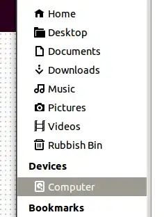

This is the first time I made my laptop 100% Linux. I installed the latest version of Ubuntu 14.04.2. I am a windows user and in the ubuntu installation I selected "Erase Disk and Install Ubuntu". After the installation I expected to see some partitions in Devices > Computer just like how I can see partitions like C: , D: etc in windows.

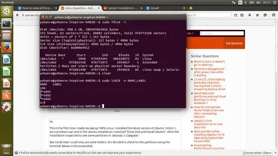

But inside that I could only see some folders. So I decided to check for the partitions using the terminal. Below is the screenshot.
I copied the commands from internet and I have no clear idea about what my partitions are. Can someone please help me to identify my partitions?

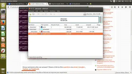

Below is the screenshot of gparted.
hmm.. Seems like I have only 1 big partition. Can some one please help me to "re partition" this to atleast 3 partitions?

From the fdisk and lsblk output we can see that:
The only partition you should expect to see is the root partition, since swap isn't for direct usage. It will look something like this:
As for re-paritioning, note the key icons next to all the partitions - they can't be modified. And that's because they're all in use. To modify them, you'd have to boot to a live CD, so that they're not in use. See Why I'm seeing a lock besides the partition I'm trying to modify with gparted? or How to resize partitions?

  1. Boot a live system.
  2. Open GParted.
  3. Delete sda5.
  4. Delete sda2.
  5. Resize sda1 from the right to the left.
  6. Create a new extended partition taking in all of the remaining space.
  7. Create a new swap partition.
  8. Create the other partitions you want.
  9. Boot into your installed system.
  10. Open GParted.
  11. Right-click on your swap partition and choose "swapon".
  12. Right-click it again and choose "Information".
  13. Copy the UUID to the clipboard.
  14. Update the swap line in /etc/fstab.
Notice that you should back up your data since changing something on your partitions comes with a risk of data loss, especially in case of a power failure.
