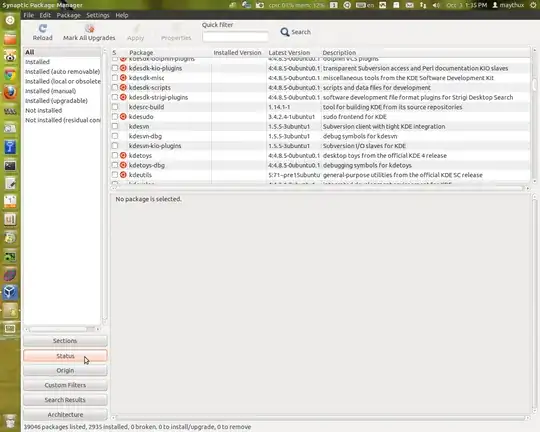

This usually happens as a result of 'Unmet dependencies for installed packages'.
Here's a simple solution if you have 'Synaptic' installed:
  • Open Synaptic.
  • Go To 'Status' (in the left navigation).
  • Choose 'Broken'.
  • Remove these broken packages.
Otherwise it can be dealt via CLI:
Open terminal and run this command:
sudo apt-get clean
Above command will clean out the local repository of retrieved package file.
sudo apt-get install -f
Will correct broken dependencies i.e. -f here stands for “fix broken”.
sudo dpkg --configure -a
will configure all (-a) the packages which haven't been configured yet. In the end do run the update command sudo apt-get update.
jokerdino
  • 41,732
19
Open synaptic Install synaptic. Then go to status and choose Broken. Then remove completely the broken packages.
This should correct your system.
