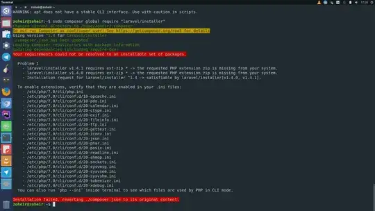

When I run this command sudo composer global require "laravel/installer" it produces this output:
Changed current directory to /home/zoheir/.composer
Do not run Composer as root/super user! See https://getcomposer.org/root for details
Using version ^1.4 for laravel/installer
./composer.json has been updated
Loading composer repositories with package information
Updating dependencies (including require-dev)
Your requirements could not be resolved to an installable set of packages.
  Problem 1
    - laravel/installer v1.4.1 requires ext-zip * -> the requested PHP extension zip is missing from your system.
    - laravel/installer v1.4.0 requires ext-zip * -> the requested PHP extension zip is missing from your system.
    - Installation request for laravel/installer ^1.4 -> satisfiable by laravel/installer[v1.4.0, v1.4.1].
  To enable extensions, verify that they are enabled in your .ini files:
    - /etc/php/7.0/cli/php.ini
    - /etc/php/7.0/cli/conf.d/10-opcache.ini
    - /etc/php/7.0/cli/conf.d/10-pdo.ini
    - /etc/php/7.0/cli/conf.d/20-calendar.ini
    - /etc/php/7.0/cli/conf.d/20-ctype.ini
    - /etc/php/7.0/cli/conf.d/20-exif.ini
    - /etc/php/7.0/cli/conf.d/20-fileinfo.ini
    - /etc/php/7.0/cli/conf.d/20-ftp.ini
    - /etc/php/7.0/cli/conf.d/20-gettext.ini
    - /etc/php/7.0/cli/conf.d/20-iconv.ini
    - /etc/php/7.0/cli/conf.d/20-json.ini
    - /etc/php/7.0/cli/conf.d/20-phar.ini
    - /etc/php/7.0/cli/conf.d/20-posix.ini
    - /etc/php/7.0/cli/conf.d/20-readline.ini
    - /etc/php/7.0/cli/conf.d/20-shmop.ini
    - /etc/php/7.0/cli/conf.d/20-sockets.ini
    - /etc/php/7.0/cli/conf.d/20-sysvmsg.ini
    - /etc/php/7.0/cli/conf.d/20-sysvsem.ini
    - /etc/php/7.0/cli/conf.d/20-sysvshm.ini
    - /etc/php/7.0/cli/conf.d/20-tokenizer.ini
    - /etc/php/7.0/cli/conf.d/20-xdebug.ini
  You can also run `php --ini` inside terminal to see which files are used by PHP in CLI mode.
Installation failed, reverting ./composer.json to its original content.
Here's an image showing the error:
screenshot of the error shown in a terminal window with color highlighting

You need to install php zip extension.
Something like
sudo apt-get install php7.0-zip
should get you on the right lines
Depending on installed php version you may need to change the package you need to install, eg
  • php-zip
  • php5.4-zip
  • php7.0-zip
  • php7.1-zip
Easiest way to find php version is to run
php -v
cosmorogers
  • 657
Doing something like
sudo apt-get install php7.2-zip
Solves the issues. Replace 7.2 with your desired version.
