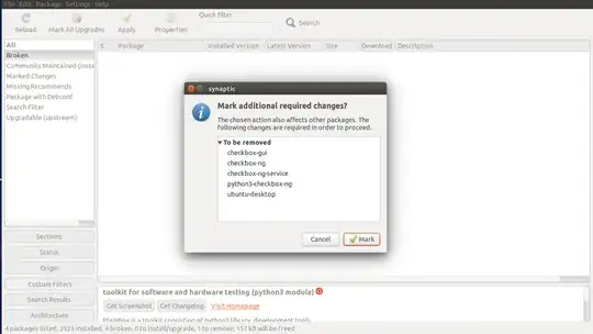

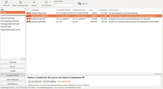

Searching for solution to fix broken package lead to this answer which recommended removing broken packages using synaptic(which i installed before the problem).
The synaptic package manager shows four broken packages
I then selected a single package python3-plainbox and marked as for removal which then again showed other packages depending on this package enter image description here
the other three broken packages also show some varied packages depending on them. I tried to re install the broken packages using synaptic manager but its throwing error. Should I remove it

After many hours of searching, tweaking and all other kind of things I have found a solution to this problem
All the below steps are done without rebooting
  • First I removed all the four broken packages using synaptic programme manager(mark as removal).
