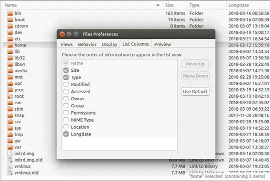

This blog post shows a much easier solution. It is based on creating an extension which can be selected as an alternative "modified column". Tested under 16.04.
  1. gedit ~/.local/share/nautilus-python/extensions/longdate.py
  2. Use this code (always copy code you trust):
    #!/usr/bin/env python
    import os import urllib import datetime from gi.repository import Nautilus, GObject
    class ColumnExtension(GObject.GObject, Nautilus.ColumnProvider, Nautilus.InfoProvider): def init(self): pass
    def get_columns(self):
        return (Nautilus.Column(
            name="NautilusPython::Longdate",
            attribute="longdate",
            label="Longdate",
            description="Get long date"),)
    def update_file_info(self, file):
        if file.get_uri_scheme() != 'file':
            return
        filename = urllib.unquote(file.get_uri()[7:])
        statbuf = os.stat(filename)
        formatteddate = datetime.datetime.fromtimestamp(statbuf.st_mtime).strftime('%Y-%m-%d %H:%M:%S')
        file.add_string_attribute('longdate', str(formatteddate))
  3. chmod +x ~/.local/share/nautilus-python/extensions/longdate.py
  4. sudo apt install python-nautilus
  5. nautilus -q and nautilus . to restart Nautilus and see if it properly loads the extension.
  6. Select the new "Longdate" column in the list column preferences.
The result will look like this:
example
