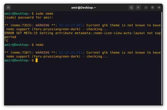

A new Ubuntu user here, I want to replace nemo as my file manager, done everything else and it is working except thisenter image description here error, appreciate any help.

when switching to nemo, did you remove the other file manager?
And then after removing the other filemanager/if not already removed, you can set up Nemo to handle the desktop completely with the following commands
xdg-mime default nemo.desktop inode/directory
application/x-gnome-saved-search
then
gsettings set org.gnome.desktop.background show-desktop-icons false
gsettings set org.nemo.desktop show-desktop-icons true
The first command disables the handling of desktop by Nautilus and the second one enables Nemo to take its place.
