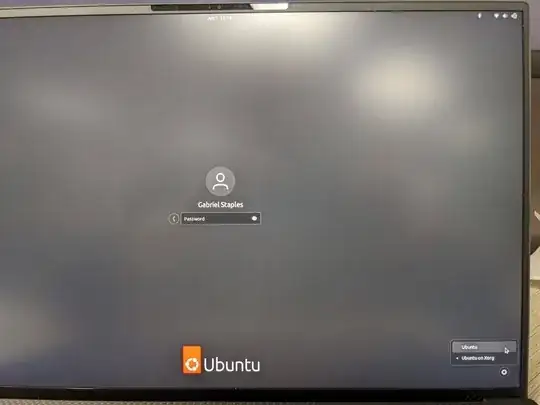

To use the X11 Window Manager in Ubuntu 20.04, 22.04, etc.:
  1. Log out of Ubuntu.
  2. At the login screen, click your username to begin typing your password.
  3. This enables a little gear icon in the bottom-right, to select your window manager. Click that to select your window manager. Choose the non-Wayland option! If currently set to the Wayland option, then it will show "Ubuntu" [which means Wayland in this case] and "Ubuntu on Xorg" [which means X11]. Choose the "Ubuntu on Xorg" option. Here is a screenshot:
For additional screenshots and the most up-to-date info. in this, see my other answer here: Wayland window manager causes my computer to stay on a black/blank screen and not wake up

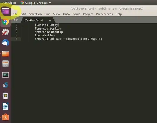

    gedit ~/.local/share/applications/show-desktop.desktop
    "When the file opens, paste following lines and save it."
    [Desktop Entry]
    Type=Application
    Name=Show Desktop
    Icon=desktop
    Exec=xdotool key --clearmodifiers Super+d
  3. "Finally search for ‘show desktop’ in application menu, then right lick and select ‘add to favorites’:"
    "That’s it. Enjoy!"
    Here it is, as shown on my desktop:

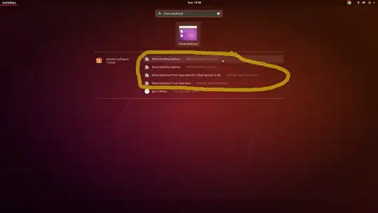

Click your "Start menu" icon thing (9-dot icon) and type in "show desktop." Wait a few seconds for search results to pop up, and click on and install one of the Gnome Shell extensions. (Note that these search results are simply coming from the Ubuntu Software center).
For more info on Gnome Shell Extensions, see my other answer here: https://askubuntu.com/a/1089033/327339.
Ex: here's the first one: enter image description here

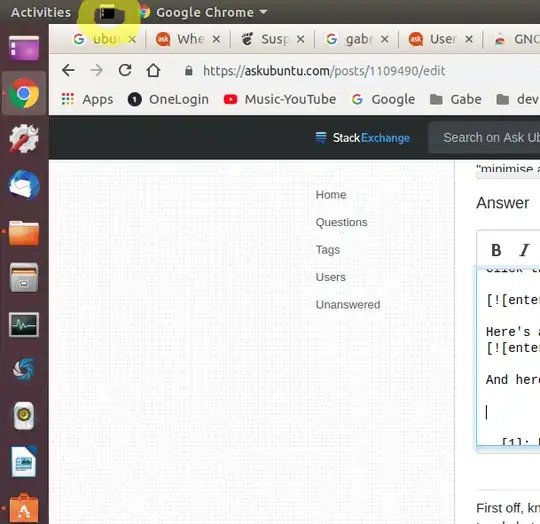

Click the "Install" button and here's what it looks like on my desktop:

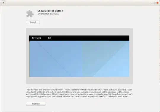

Option 2.B:

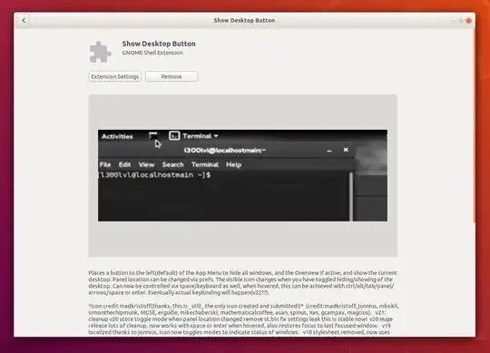

Here's another one [used to be my personal favorite, but then I switched back to Option 1 because it seems to work the smoothest and be the most consistent]:
And here's what it looks like installed: enter image description here
