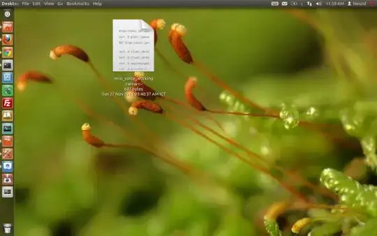

This is my desktop, the icon is too big. enter image description here
I tried to use
gsettings set org.gnome.nautilus.desktop font "Ubuntu 9"
but the it changes only font size of the desktop icons.
I tried to use Compiz, Advance Settings and Configuration Editor but they just have font size option, not icon size option.
How to change the desktop icon size?

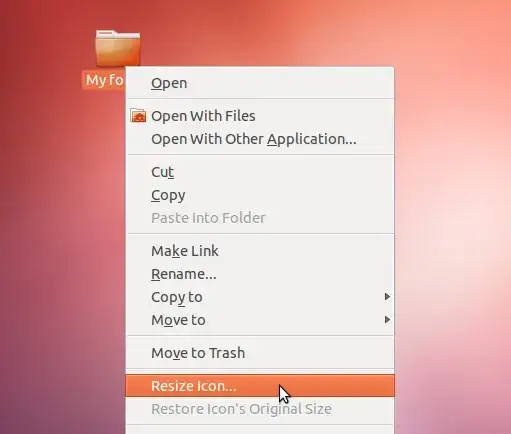

  1. Right click the icon you want to resize. Select "Resize icon..."
    Screenshot of mouse hovering over "Resize icon..." option in context menu.
  2. Hold-click and drag the handles that appear over the icon to resize it.
    Screenshot of mouse dragging icon handles to make icon larger.
You can revert to the icon's default size by selecting "Restore Icon's Original Size" in the icon's right-click context menu.

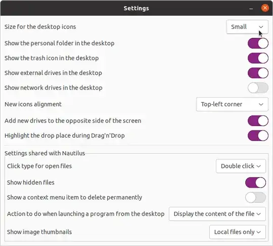

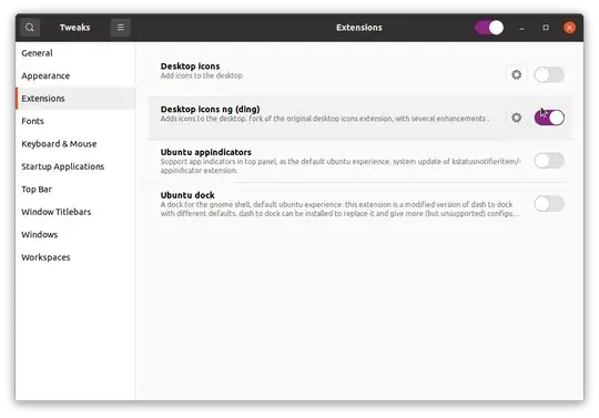

In ubuntu 21.04:
  1. run gnome-tweaks in terminal
  2. click extensions
  3. turn on Desktop icons ng (ding) (not Desktop icons)enter image description here
  4. Right click on the desktop -> settings
  5. Select size for desktop icons enter image description here

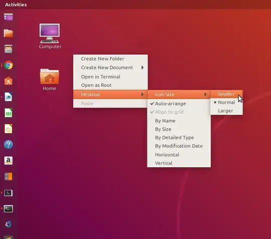

If using nemo as your file and desktop manager, simply right-click and go to Desktop --> Icon Size, as shown below. If you're not using nemo as your file and desktop manager, you should be. See the end of the answer linked-to above to see comparisons and screenshots to show the difference.
To find out why you'd want to use nemo as your file manager instead of Ubuntu's default nautilus, and to find out how to install it and set it up, see here: How to set Nemo as the default file manager in Ubuntu 18.04?.

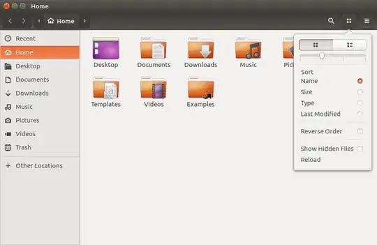

If one opens Files and selects the display type (icons or lists) button, it allows one to change size with the slider. This affects the open window and everything that is on the desktop. I still have to re-arrange but main problem is fixed.
