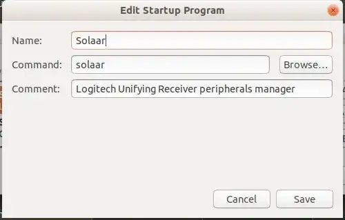

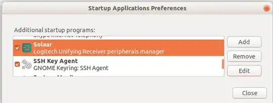

Lastly, we need solaar to auto-start at startup. Open your Startup Applications GUI program and look for a "Solaar" entry. I have one here. If you don't have one, click "Add" to add one. If you do have it, click "Edit" to look at it.
Ensure in the "Command" box it says solaar. This starts the application by running the solaar command each time you log into your system graphically.

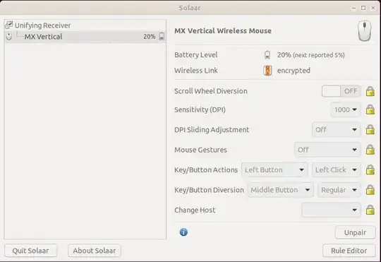

If you just ran solaar & above, a Solaar GUI window will pop up. It looks like this for me (I have the Logitech MX Vertical Wireless Mouse (renewed), or new, because it helps me with my carpal tunnel in my wrist, and has a nice scroll wheel with (supposedly) an optical encoder which won't break on me in 1 year of use like mechanical scroll wheel encoders do):

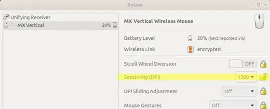

Notice the locks to the right of each setting. Click those to cycle through 3 modes for each setting: Locked --> Ignored --> and Unlocked (changes allowed).
Here you can see I unlocked my "Sensitivity (DPI)" setting to increase it from 1000 to 1300:
When done changing settings, click the lock icon to get it to lock again.
Now you can click the X in the top-right of the Solaar window to close it. Solaar will keep running in the background.

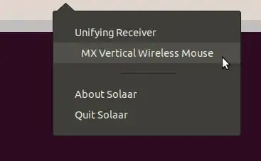

In the top-right of your screen you'll see this little Solaar battery icon, which is super convenient: enter image description here
Click it and go to "MX Vertical Wireless Mouse" (or whatever the name of your device is) to re-open the GUI settings window shown above to change more settings.
