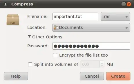

You can also right-click on a folder or file(s) in Nautilus and select "Compress...". In the resulting window, you can expand the "Other Options" section to enter a password.
alt text
If the password field or any of the other options are not enabled, then the selected compression option does not support it. Select a different one from the list after the filename. According to the documentation:
Currently, only 7-Zip, ZIP, RAR and ARJ archives support encryption
