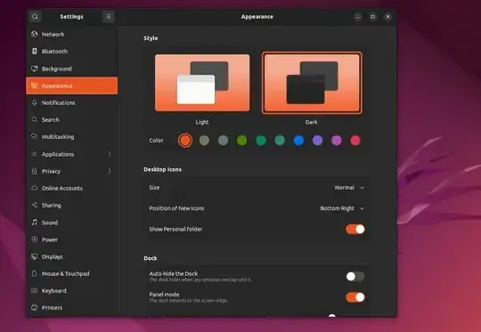

23
In "Settings", "Appearance", uncheck the option "Show Personal folder" in the section "Desktop Icons".
