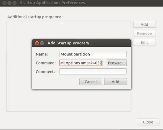

Go to the Startup Applications, by Clicking right-top corner Settings icon ---> Startup Applications.
The click on the Add button, Write a name for this operation such as "Mount ntfs drives", then in command input box, write this udisks --mount /dev/sda2, to automount the ntfs partition.
Note: You need to replace the /dev/sda2 with your actual NTFS partition number.

For Mounting with Executable permission
For those of you (like me) who wants to have executable permission to be set upon mounting, so that you can have options for execute a file with double-clicking , Add this extra bit of options with udisks command.
--mount-options=umask=022
So, the total line for /dev/sda2 should be like this (tested on 13.04)
udisks --mount /dev/sda2 --mount-options=umask=022
