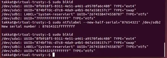

To mount an NTFS drive we can also use a disk label only. We can safely change the label from Windows or by using ntfslabel Install ntfslabel. See
Needless to say that by using ntfslabel we can also change a partition's UUID (aka serial number). To avoid negative effects on the UUID dependent Windows file allocation we should only change the upper part of the UUID (which is not used by Windows):
sudo ntfslabel --new-half-serial[=ssssssss] /dev/sdXN
Example:
