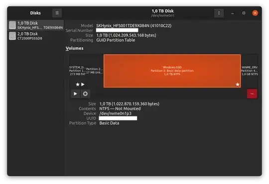

  2. Open "Disks" application (can be found by directly searching disks under applications). On its main window, "Disks" graphically shows you your current partition layout, as in the following screenshot. example_disk_dual
  3. Now choose the NTFS partition that you want to automatically mount on boot (as in the previous screenshot), then click on the small gears icon slightly below it. From the menu choose Edit Mount Options...

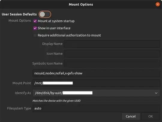

  4. From the next window that is shown, move the slider button to the left to gain access to the settings. Depending on the Ubuntu version you are running the label next to the slider can be either Automatic Mount Options or User Session Default. example_edit_mntopt
  5. Keep the check-marked option Mount at startup. Select/Fill the next four options if you wish. "Display Name" is a handy visual aid in Nautilus (file manager).
  6. Once done, click on the OK button at the bottom. When asked, enter your administrative password.
