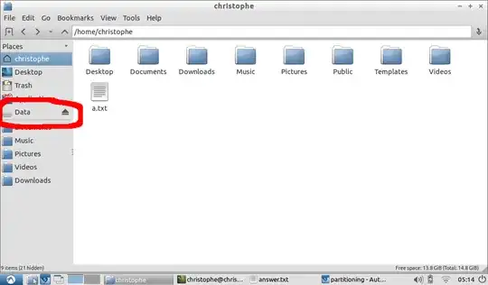

    • Conclusion: It does work BUT it does not appear as a media in file manager (nautilus, PCManFM, ...) [see file_manager.png]

    • Conclusion: It does work AND it does indeed appear as a media in file manager (nautilus, PCManFM, ...) [see file_manager.png]file_manager.png
