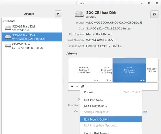

I should be possible to tell directly to the disk manager to hide the disk; I can't test because I have not spare partition on this PC.
Open "Disk utility" via the dash, and select the "mount option" for your partition:
disk utility

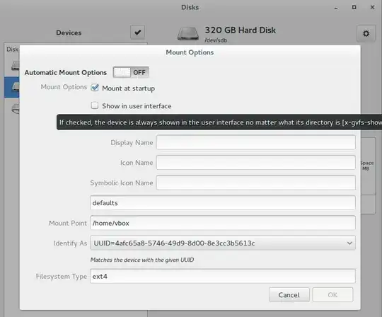

After that, you should be able to tell the system not to mount it at boot and not make it available in the graphical interface:
partition mount options
...good luck!
