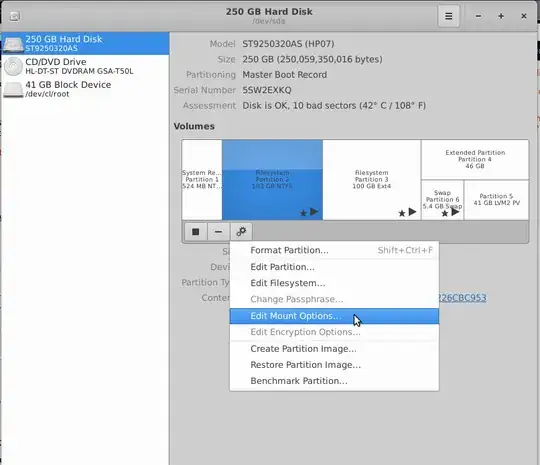

All info above is good - but this is the EASIEST
  • Use the "Disks" application. If you don't have it, you can install it with sudo apt install gnome-disk-utility
  • click on the partition you need to auto mount,
  • click on the little cog wheel [Settings Icon] - for Additional partition options.

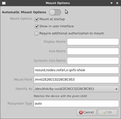

  • then Edit Mount Options as you need
1- Toggle 'Automatic mount option' 2- Check 'mount at startup' option 3- Change other settings if you need
Disks Application Image
Mount Options Window Image
