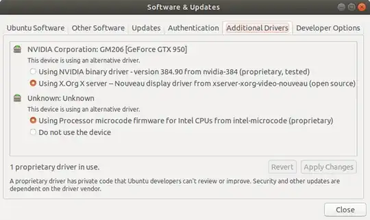

Most drivers are included in Ubuntu. If you need to install proprietary drivers that can't be included in Ubuntu, then you can get them automatically from the Software & Updates application.
karel
  • 122,292
  • 133
  • 301
  • 332
Ubuntu 20.04: (@) -> Preferences -> Software Sources ; password;
if |Additional Drivers| tab area is blank, then:
|Ubuntu Software| tab: check box [x] Proprietary drivers for devices (restricted)
[Close] button. Then [Reload]. System reloads its capabilities. Re-open the Software Sources app again.
go back to |Additional Drivers| tab: "Searching for Available Drivers", takes a few seconds, then it populates.
check radio button (*) Using NVIDIA driver metapackage from nvidia-driver-450 (proprietary, tested)
[Apply Changes] button in lower right
go back to |Ubuntu Software| tab and uncheck box [ ] Proprietary drivers for devices (restricted), if you wish to ensure tight security
