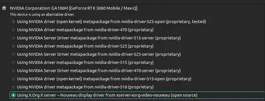

I installed NVIDIA driver (open kernel) metapackage from nvidia-driver-525-open(proprietary, tested) from the Software and Updates app.
Available drivers to install:
available drivers to install
I a found way to get the machine to boot. Open the terminal pressing the power button and Shift after that I ran in the terminal sudo apt remove --purge '^nvidia-.*' and the laptop boots.
