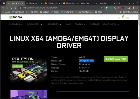

However, driver 440 is available at https://www.nvidia.com/en-us/drivers/results/159360/ (Apr 07, 2020).
This download is not a package but an installer that will verify your system for compatible drivers and should install the latest version.
The installer is run through the terminal.
Note: You may need to change the file permissions with `chmod u+x filename' and then execute.

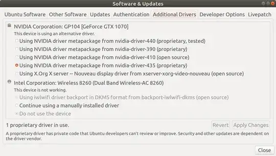

Option 1: Graphical User Interface (GUI) method
Get to the so called Additional Drivers window. This is a tab inside an application called Software and Updates. Bellow example on how it should look like.
Note: I recommend selecting the latest nvidia-driver-440 (as of May 30, 2020 for ubuntu 18.04) unless you have specific need for a different version. I am using an SDK that requires the use of proprietary driver 435.
Additional Drivers

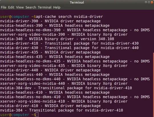

In a new terminal window, find current available drivers with command
apt-cache search nvidia-driver
Nvidia Drivers Found
Only worry about the drivers that begin with nvidia-driver. In the example about the newest driver would be nvidia-driver-440.
