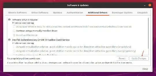

How can I install additional drivers in kubuntu like in gnome and this screenshot? enter image description here

You have to start System Settings (systemsettings5) and select Kubuntu Driver Manager application from it.
Note: Kubuntu Driver Manager may be launched from the terminal using sudo kubuntu-driver-manager command.
