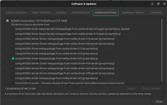

I am running the NVidia Geforce GTX 1660 and I've had some issues in the past while running Ubuntu 22.04.1 LTS
  1. Here is the driver that my system works really well with:
470 driver
  1. Remove wayland and run the X windowing system (How do I use X instead of wayland on 22.04?)
