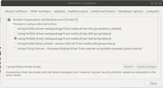

I am experiencing some trouble with my graphical card (Sometimes my GPU crashes and I have to reboot my PC). I suspect it might have something to do with a faulty driver that is chrashing. While looking into my drivers in Ubuntu, I noticed a lot are available:
What are the differences between all these drivers, which one should I pick and why?
I am asking this because my GPU keeps crashing (Also on windows), therefore I might need another driver than the default one. Trying to automate this process with sudo ubuntu-drivers autoinstall throws the following error:

This indicates that the problem is unlikely to be software after all. Why do you conclude that it is the "GPU" that crashes? Did you look into kernel logs or the X server logs?
I would suspect it could be a hardware problem, including a faulty graphics card, motherboard, power supply, or memory errors. Replace the graphics card, and then run whatever system tests the BIOS gives you (or boot into the memtest option, if you have that).
And fix the broken packages, either cycle apt update and upgrade, or apt remove all the problematic packages and then reinstall the correct driver package.
