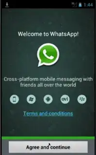

  3. Whatsapp will ask for mobile varification. choose your country and enter your mobile number, in order to verify the mobile SIM card.
    Whatsapp ubuntu

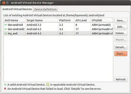

In order to run Android emulator, you first need to create a new AVD (Android Virtual Device) which is an emulator configuration for the Android device to be emulated. To create a new AVD, first launch Android SDK Manager by running the following.
 ~/android-sdks/tools/android
Go to “Tools” > “Manage AVDs” on Android SDK Manager’s menu. It will open up AVD Manager.

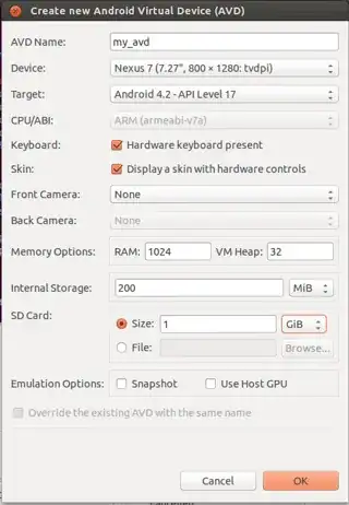

Click on “Add” button to create a new AVD. An example configuration of a new AVD is shown below.

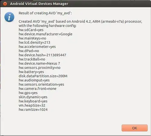

If an AVD has been successfully created, you will see the following confirmation.
You can check the list of available AVDs as follows.

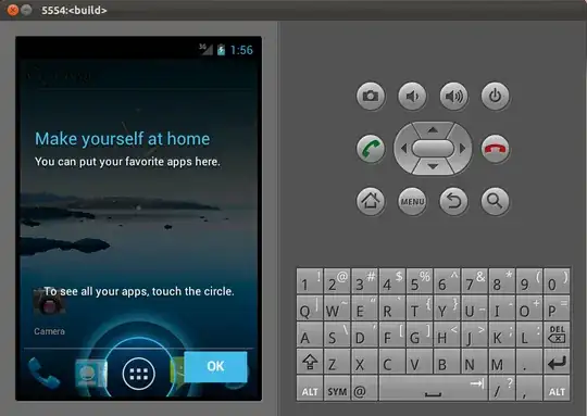

To launch Android emulator with the AVD that you have created, highlight the AVD on AVD Manager, and click on “Start” button on the right sidebar.
Alternatively, you can start Android emulator directly from command line as follows. In this case, specify “@[your_avd_name]” as an argument to the emulator.
 emulator @my_avd
Booting up Android emulator may be slow (even taking minutes) depending on your hardware. Once Android emulator is successfully launched, you will see an running instance of Android device.

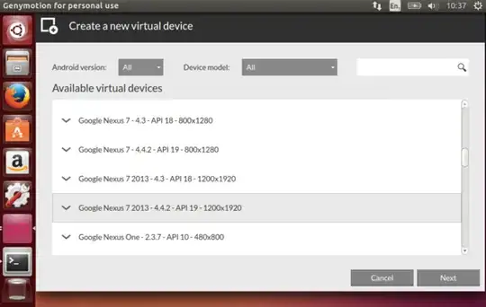

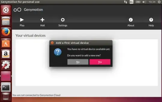

  • Click Yes to add your first virtual device enter image description here

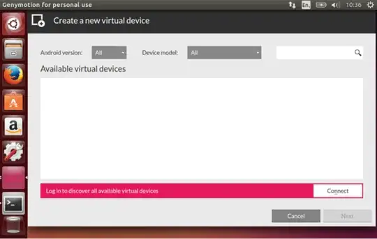

  • Click Connect to login and install a device enter image description here
  • Select desired device and click Next enter image description here

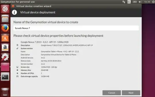

  • Enter a name for your device and click Next enter image description here

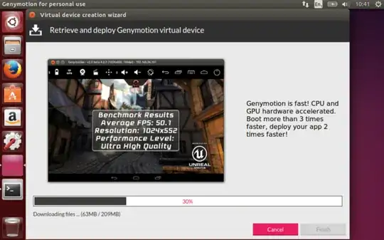

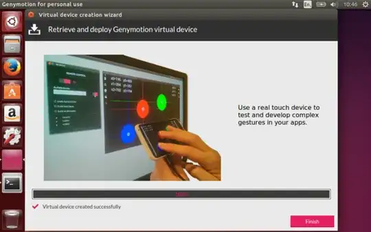

  • Wait until your virtual device is downloaded and deployed enter image description here
  • Click Finish enter image description here

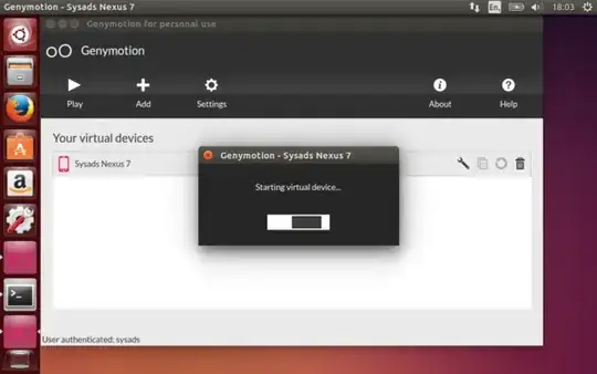

  • Click Play to start the emulator enter image description here
