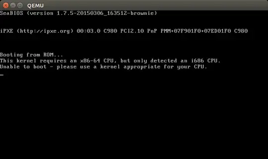

If you see a wall of text scroll by and eventually panic (because the root FS is missing), you have installed a 32-bit kernel. If instead you receive an error similar to the one displayed below, you have a 64-bit kernel (which will not boot on an x86 CPU).
