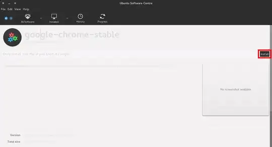

Then double-click the file, this should open the Ubuntu Software Center, to install click the Install button and then enter your password as prompted (your Ubuntu Software Center may look slightly different to mine in terms of design as I am on the GNOME flavour of Ubuntu):
Software center
In the above screenshot I have put a red box around the Install button you need to press.

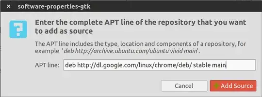

  2. Add the following line :
    deb http://dl.google.com/linux/chrome/deb/ stable main
    Software properties
  3. Click Add Source and enter your password.

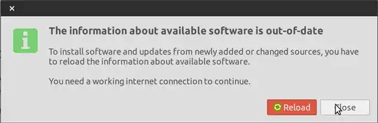

  4. Select Close and click Reload on this screen :
