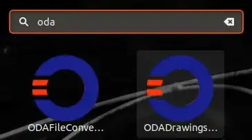

This will install odadrawingsexplorer package and /usr/bin/ODADrawingsExplorer GUI app.
screenshot

Same as above but with it will install odafileconverter and /usr/bin/ODAFileConverter GUI app.

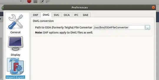

DWG converter on FreeCAD
To install and add the DWG converter to FreeCAD use latest stable FreeCAD from PPA.
sudo add-apt-repository ppa:freecad-maintainers/freecad-stable # An older version without PPA
sudo apt install freecad
It's also available on Flathub (related answer).
flatpak install flathub org.freecadweb.FreeCAD
screenshot
