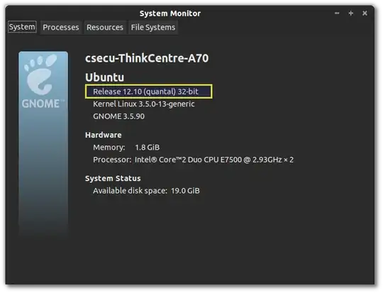

You can also see the Ubuntu architecture by Opening "System monitor" and going in the System tab.
