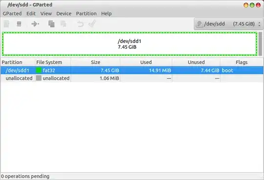

  • Insert your USB flash drive. My drive is /dev/sdd. Here's a screenshot:
GParted screenshot
  • Your drive may be automatically mounted inside /media/. Let's assume that it was mounted in /media/xxx/.

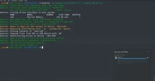

26
If by "third-party" you mean "GUI", I suggest a lightweight script named bootiso after Avinash Raj answer, because dd does not always work. The big plus is it's very secure (performs many security checks not to mess up with the system), easy to install and portable.
Also, bootiso will inspect the ISO file to choose from two modes: "image-copy" (dd) when the ISO file is hybrid (implies: USB boot friendly). And "mount-rsync" mode when ISO file is non-hybrid, in which case a SYSLINUX bootloader will be automatically installed if supported [more details about install modes].
How to use it
First option, just provide the ISO as first argument and you'll be prompted to select a drive amongst a list extracted from lsblk:
bootiso myfile.iso
Or provide explicitly the USB device:
bootiso -d /dev/sde myfile.iso
Quick install
curl -L https://git.io/bootiso -O
chmod +x bootiso
sudo apt install wimtools
See it in action
