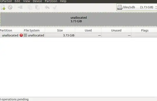

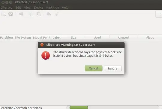

I wanted to format the USB so I can use it again, but I got this message from gparted:
If I select "Cancel", I get this:
with which I can't do anything. And if I select "Ignore" I get this message:

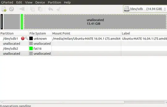

and after that I get this mess:
How can I get my USB back?
After you connect the USB stick, make sure it is not mounted and in a terminal type:
sudo dd if=/dev/zero of=/dev/sdX bs=1024 count=1 && sync.
(sdX = USB stick letter)
This will delete both the master boot record and the partition table from your stick creating a completely new and unused USB stick.
Using gparted now, you can create a new partition table and reformat it. If you want it to be readable by all operating systems, use FAT-32.

Use gparted's Device tab to create a new partition. It will prompt you that all data will be erased. Choose the default msdos for the partition table type. This will bring it back to the original partition table type.
The proceed to use the Partition tab to create the partitions you want.
