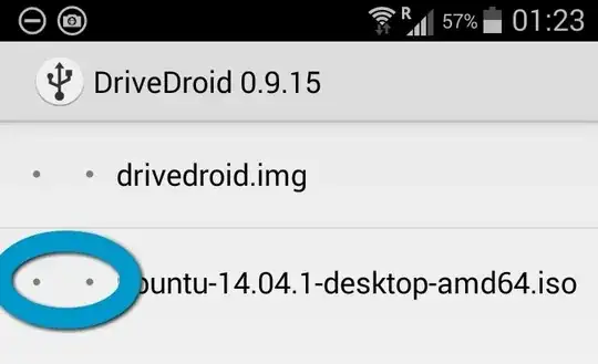

1st - After adding the .iso to DriveDroid, click on the dots next to the target. Click on the dots

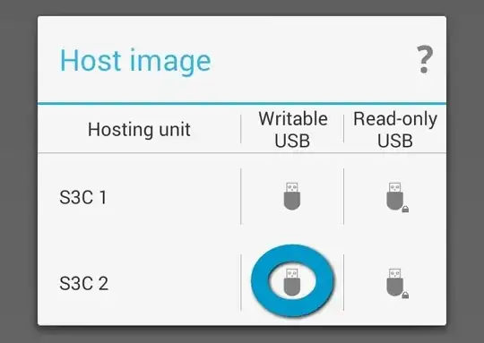

A menu will pop up, follow my screenshoots and press the first "dot" as writable. Window will close and app will return back to the main screen. enter image description here

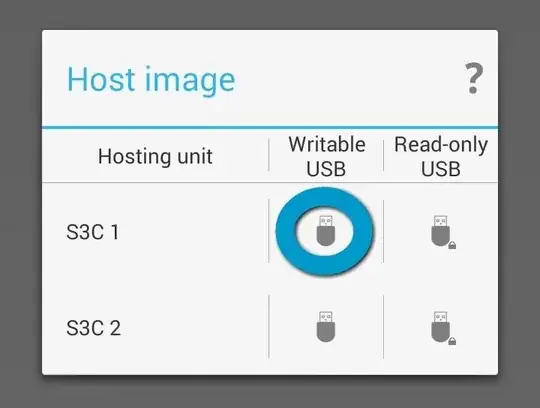

Do the same for the next mount point... enter image description here

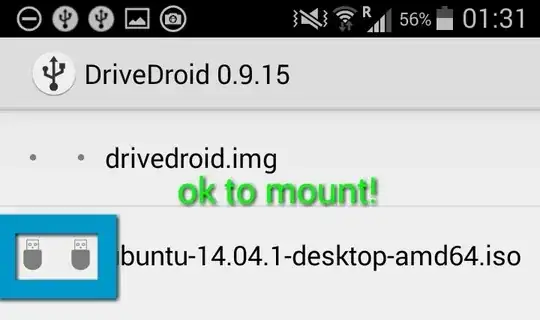

to get the final setup looking like this: enter image description here
Now you are ready to connect your phone via USB to your PC/Notebook and power it on. It should boot to Ubuntu straight away. If not, check your BIOS/UEFI settings and let the machine boot from "External Device" or "USB" first.
