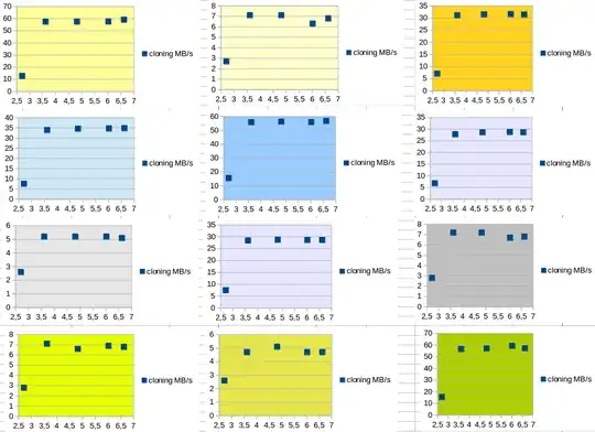

I tested again, with current Lubuntu 16.04 LTS versions, and computer hardware of different kind and age, as described in the following table and graphs.
Test details
  • The test was run with a shell-script, that for each block size wiped and synced the first Gibibyte of the target USB pendrive (overwrote with zeros), then cloned and synced from a Lubuntu iso file (which is slightly smaller than one Gibibyte, so within the wiped part of the pendrive).
  • In all cases a pure dd command line was used (no piping via pv or similar commands).
  • Most tests were run from Lubuntu 16.04.2 LTS amd64 system (with a yakkety kernel) installed in an SSD, but the tests in an HP xw8400 workstation were run with the installed Lubuntu 16.04 LTS i386 system (with a xenial kernel) in an internal HDD.
  • 'Extreme' and 'Cruzer_blade' are Sandisk USB pendrive models
  • 'drive port' is where the target USB pendrive is connected
  • 'os port' is where the SSD or HDD with the operating system is connected
  • More details are listed in the following table, and the variations due to the block size are illustrated in the following graphs with log (block size) along the x-axis because of the character of the range of block size values,
    • 512 (default)
    • 4096 (4K)
    • 65536 (64K)
    • 1048576 (1M)
    • 4194304 (4M)
dd-blocksize-test-table
dd-blocksize-test-graphs
Conclusions
  • The default block size, bs=512 (bytes) makes dd slow.
  • Cloning with block sizes from bs=4096 to 4M run at 'full speed'. There are only minor differences between the test cases (except for bs=512).
